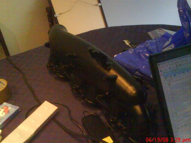

    Intake manifold will be back from powder coating today at 2:00 Will post a pic,
    I got magic black. It's a flat black with light gold flakes in it

        Rainbow powder coating in coquitlam BC.
        They are cheap too!! $50.00 for the manifold and $25.00 to sandblast it. Got it back in a day .

            Anyways, here is the picture of the intake manifold. Will post pictures up later this weekend of the engine IN the car ...FINALLY!!!!
