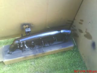

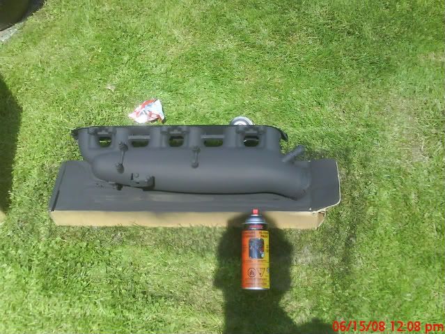

                    Anyways, did some work on the car today... Painted the intake plennum flat black with some high temp spray...**** powder coating =\

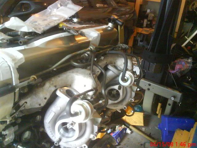

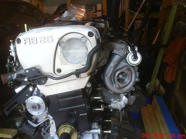

                    Turbo's are on, working on getting some elbow's to fit. They don't want to fit at all!!! =[
                    • I hope you didn't just throw those turbos on the stock exhaust manifolds.......
                      Get some aftermarket or N1 pieces.

                      • Originally posted by rockcrete View Post
                        I ported them out a bit =\. I didn't know there was n1 manifolds
                          The OEM mani are pretty good once you port/clean the up. They're cast so they won't crack like tubular units. If your not going crazy on developing the head with camshaft overlaps and late closings the oem units are ok. If you are going to go nuts on the head then you'll need a very good flowing exhaust and intake, which means no oem stuff. I've been reading alot lately. turbo mag has it's part 3 for camshaft shootout this month.. I missed part 2 though :hit_head:

                          • I have the Nismo manifolds, the ports are a lot bigger than the stock manifolds, it's pretty obvious when you put them side by side. Not only are the ports bigger, there's a lot more meat in the casting as the larger size carries all the way through the runners - a port matched stock manifold still isn't close.
                            They match up perfectly with my Nismo turbos right out of the box which are pretty similar to the Garrett or HKS2530's.

                                Stock manifolds are good for 600hp if ported (from what I remember). Don't sweat it mang.
