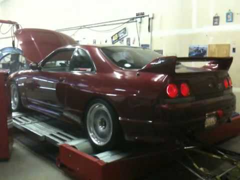

                      All loaded and ready to go!! The next morning we set off for TheBoostCreep, where I was getting tuned. My appointment was at 10AM, but we left at 7AM. Harvey's shop is about an hour from my house, and with all the snow we knew would be hell getting there. Well, about 10 minutes north of Denver, the sky opened up, and once we were out of the city limits the roads were only wet! Talk about a great day shaping up. We were almost two hours early, but after eating breakfast we pulled up and Harvey was there already waiting for us. Let the fun begin!
                      We unloaded Asuka, and into harvey's hands she went.
                      Harvey spent all day perfecting her tune, and I don't mean that figuratively, he did the most thorough work I'd ever seen. Tuning for the perfect AFR at every RPM range. Finally when it came time to do a power run we ran into the biggest issue of the day. The springs in the actuators are too stiff. They wanted to run the turbos at 22PSI and higher. We tried adjusting them but to no avail. The turbos were making the car want to dump so much fuel they were causing it to hit almost a fuel cut. Once we decided we couldn't take it any further we did a power pull and the results are promising:
                      I'm going to install the stock actuators and go back within the next couple weeks. I'm so excited to see what she can really do!
