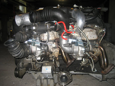

Well, I never thought I would do a “build” thread but here we are. Purchased the veh In late 2007, and basically sat on it until now, adding a few maintenance items along the way. I don’t think I am missing any key parts, and pics will follow.
I just wanted to get an idea of what the community thinks. Ideally I would like to keep stock internals….(mainly for budget, but also to keep invasive work to a minimum.)
That is unless anyone has any reason at this point why I wouldn’t.? (one member suggested I just replace the internals as I have already come this far). I am aiming for mid 500’s whp…(which I know will strain the stock internals as it is.) But, the engine is strong, good comp numbers. I am also experiencing a grind in my tranny under wot load from 2-3 and 3-4. I also notice a grind into first after extending driving periods (spirited or not). My question is that while I am getting the clutch etc done, would it make more sense to just replace the tranny with another 32 w/ less k’s? or try another route? All opinions are welcome. I am not a mechanic, but am fairly knowledgeable on this vehicle. That being said please pardon any glaring oversights I may have missed. That’s why im consulting the community. Thank you, mod lists are below.

If anyone has any other ideas I may have missed I would rather do it right the first time and have a car I can leave for awhile w/o tinkering too much. Thanks fellas. Visited the board almost everyday for almost five years, its nice to finally see some progress!
