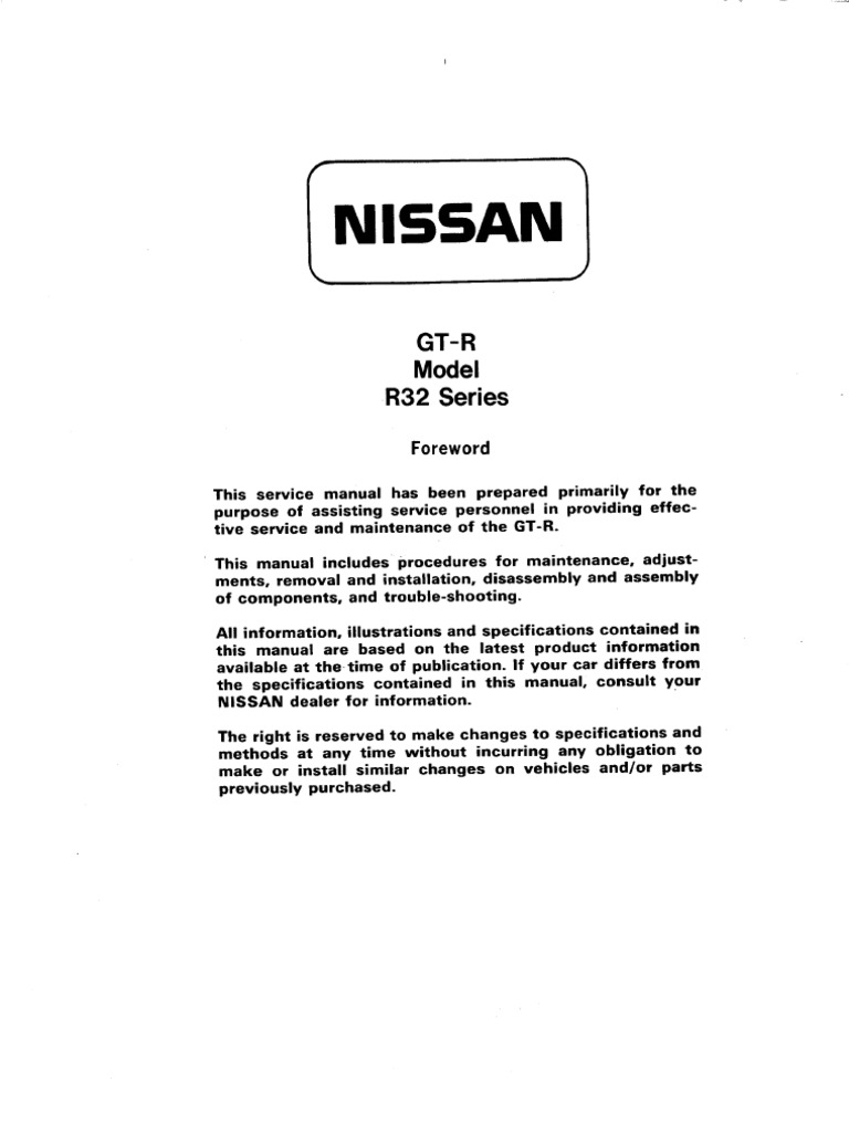

Why is the finish so rough, like sandpaper?
My new Paint Job on 92 R32
Actually, I was hesitant when I was deciding on this paint job about the undesired finish when wash and waxed, however, it turns out the matte clear coat on this beads off water so mch cleaner than a gloss finish. It leaves no water marks what so ever. Waxing it comes out very clean, even cleaner than my black crv. Imagine a gloss paint without the fibre swirls that we all hate. Just a clean slate.Originally posted by kengeroo View Postwould this sort of paint (matte) get an undesired effect when washed/WAXED ,,, or when it went through a auto car wash/wax ????Godzilla - 哥斯拉 - ゴジラ - گودزیلا - Годзилла - גודזילה
i can second this..the matte clear is definitely easier to work with, kinda a hose down and youre done deal. still looks nice.Originally posted by Rides View PostActually, I was hesitant when I was deciding on this paint job about the undesired finish when wash and waxed, however, it turns out the matte clear coat on this beads off water so mch cleaner than a gloss finish. It leaves no water marks what so ever. Waxing it comes out very clean, even cleaner than my black crv. Imagine a gloss paint without the fibre swirls that we all hate. Just a clean slate.Victory is on the horizon..
even tho the goal was to paint matte clear. it doesn't give the same effect as the benz's matte paint.Need detailing done to your car? I'm open to travel to detail your car :
