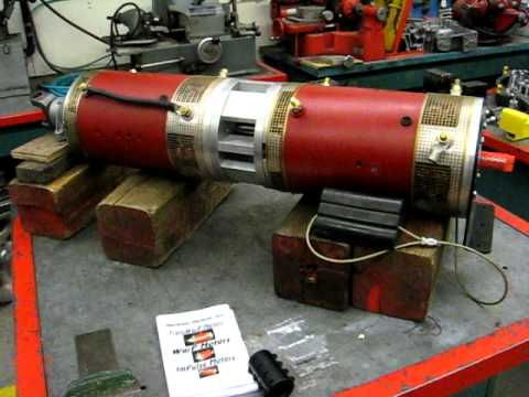

                                2 motors coupled
