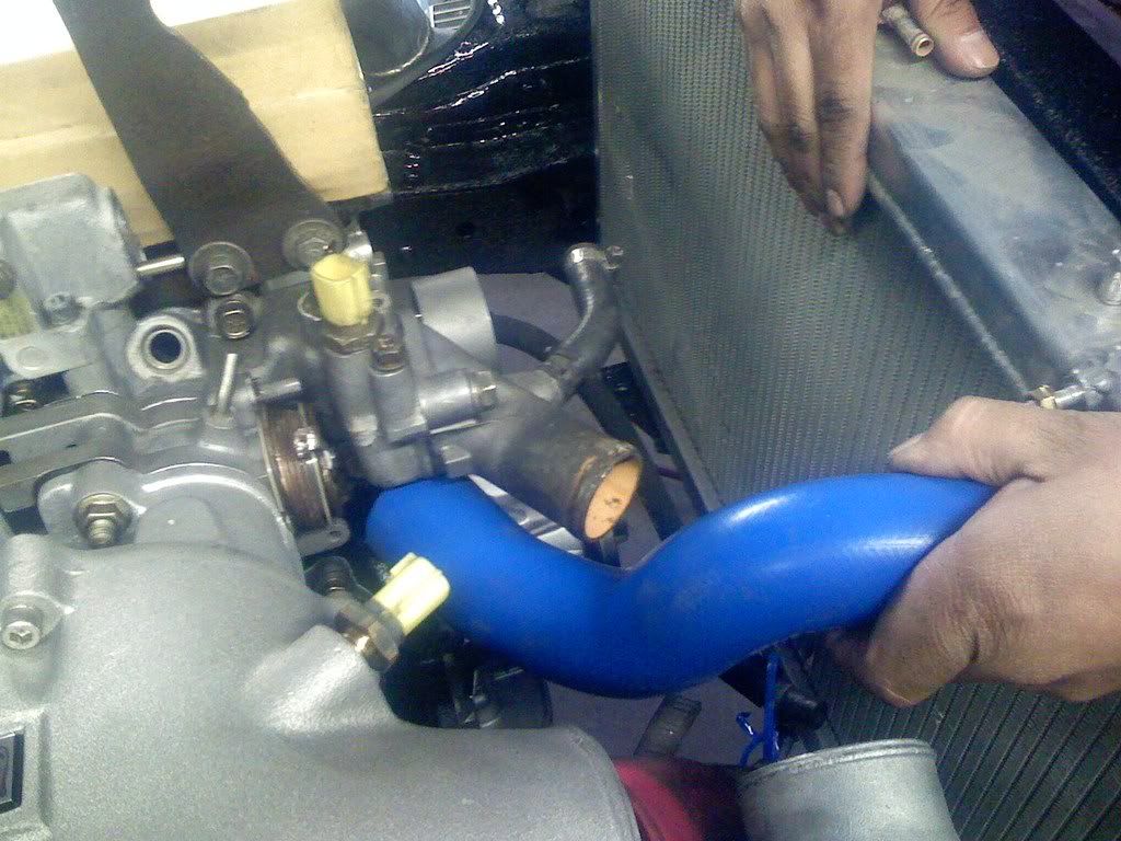

                          Another Problem.....are you excited ??
                          well this one is a small problem and is that the upper rad hose don't fit due to the extra block height
                          greddy large intercooler pipes is too short
                          greddy Large side pulley kit is too big and will not be compatible with ATI damper
                          so these are for sale if anyone wants
                          more comming soon
