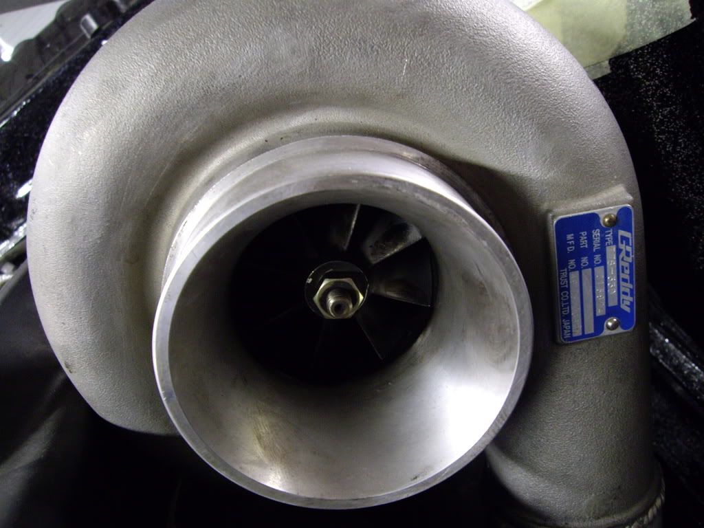

      • Originally posted by felix yuen View Post
        T78-34D
        I thought the TDO7 exhaust housing was supposed to be significantly smaller than the TDO8. I had no idea there would be a clearance issue. I guess it can only be attributed to the taller deck and because of the tilt of the engine, it puts the turbine closer to the strut tower.
        Just imagine what clearance issues you are going to have with a full T88 or something similar....

        • major problem is that it is taller,
          the turbo kit was ment to fit between the notch in the shock tower,
          if it was lower it would fit perfect.
          oh well....we made it fit

                  • ok here is the end of the week update !
                    wow i have a spoon part on my nissan gtr.
                    it is a spoon low temp thermal switch
                    FAL fan for Supra
                    with custom mount to the rad welded
                    custom mounted fuse box
                    heat wrap wires
                    clutch lines finished
                    Ti exhaust mounted
                    this is something tricky
                    because the engine is taller, all the pipes needs to be longer, and because i have a greddy manifold, the intake pipe needs to be 4" instead of 3"
                    so we cut and weld + extended the intake pipe from the IC, also made it 4"-3"
                    some hose clamps
                    I NEED TO SELL MY GREDDY 272/10.8 CAMS ! $450CND...i got BIGGER !
