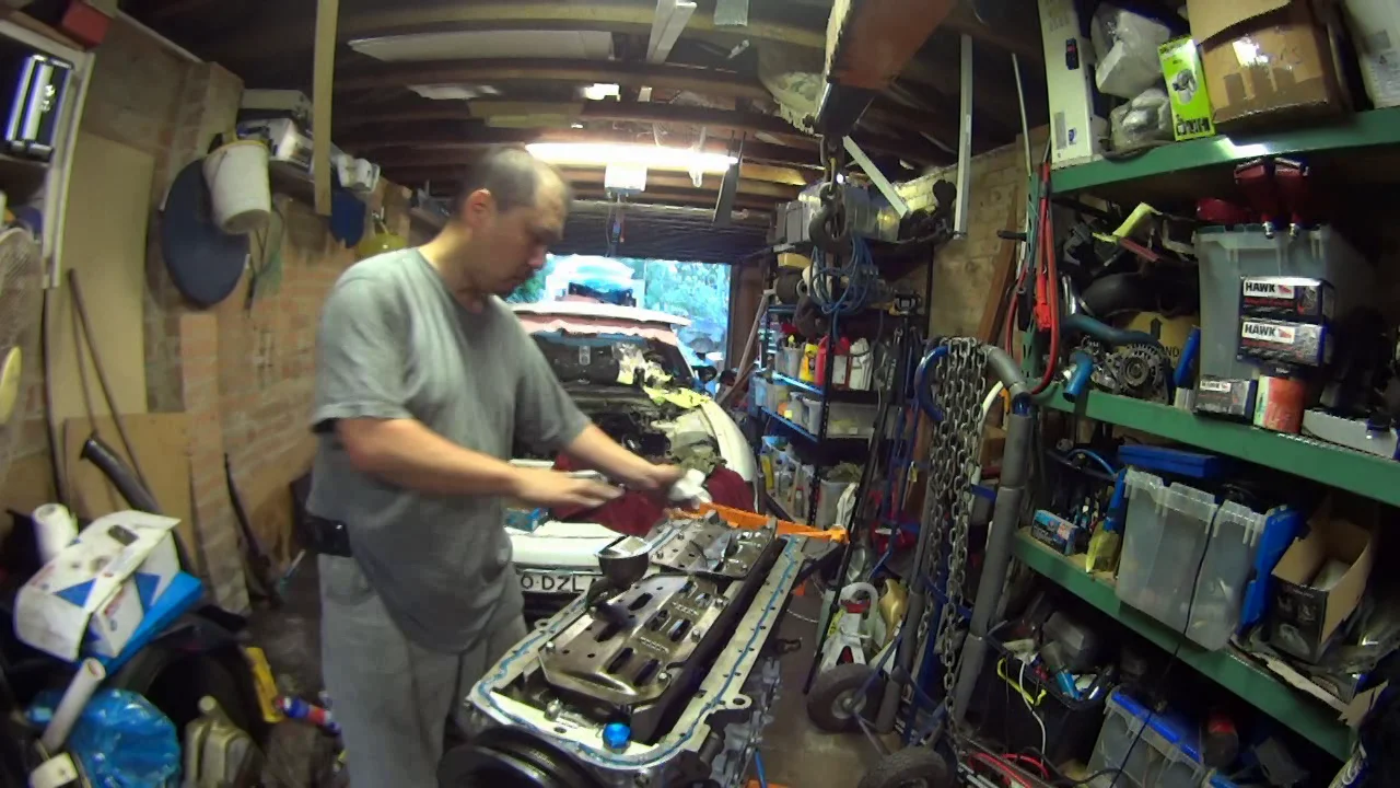

I pull mine 2 months ago (its a gts-t)
Pull it from the top with the transmission, no damage, very clean and not very hard to do (I'm not a mechanic).
as you can see on the picture the car is not very high from the ground.
I removed :
- turbo (only to be safe)
- shifter (so it can fit under the car)
- radiator (a must)
You have plenty of space, I even kept the AC rad.
This picture shows then engine right after the pull :
I removed :
- radiator (a must)
