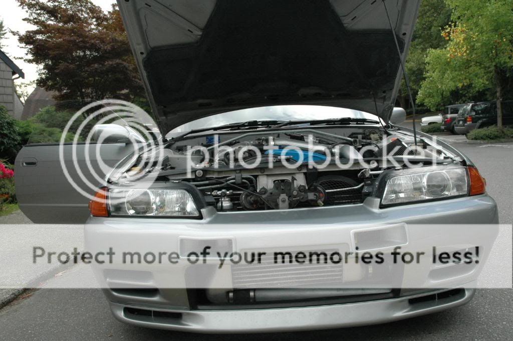

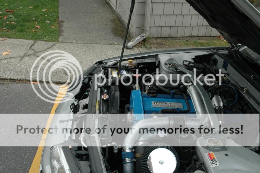

    In progress build, looking for 400hp at the engine summer 2010, working on supporting mods for now and other adds.
    My 92 gts-t
    Current mods
    -Trust Intercooler (beat up)
    -yellow jacket performance coil-packs
    -ngk spark plugs
    -new AEM rotors front and new brembo rears
    -hawk hp+ break pad
    -new vacuum lines
    -manual boost controller
    -apexi boost gauge
    -hks turbo timer
    -new downpipe
    -new testpipe
    -exotic speed catback exhaust
    -pop charger air filter
    -new speedo cable
    -eneki rp02 rims 17 X 8 +38offset all around refinished 225/45/zr17 front and 245/40/zr17 rear
    -Refinishing was done at Panther Recommended for sure

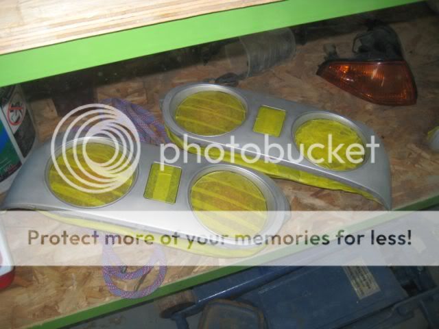

    -full paint job, including door jams, new clear on signals and tail lights
    -gts-t type m spoiler painted
    -r32 gtr N1 Oem bumper with air ducts + Painted Lip
    -nismo rear control arms
    -JIC coilovers
    -walbaro fuel pump
    -synapse blow off valve
    -type M side skirts and rear valance
    currently running 0.9bar on stock rb20 turbo on 94 octane

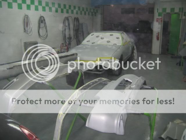

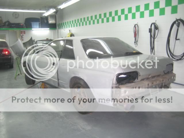

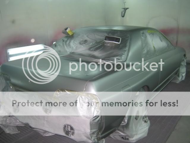

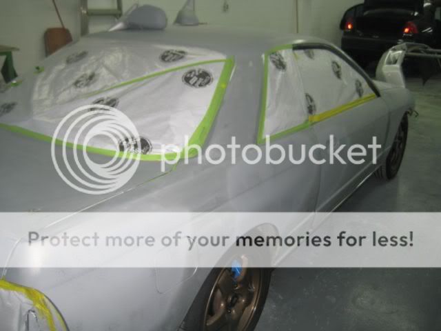

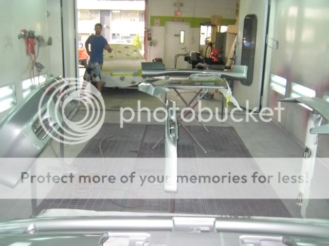

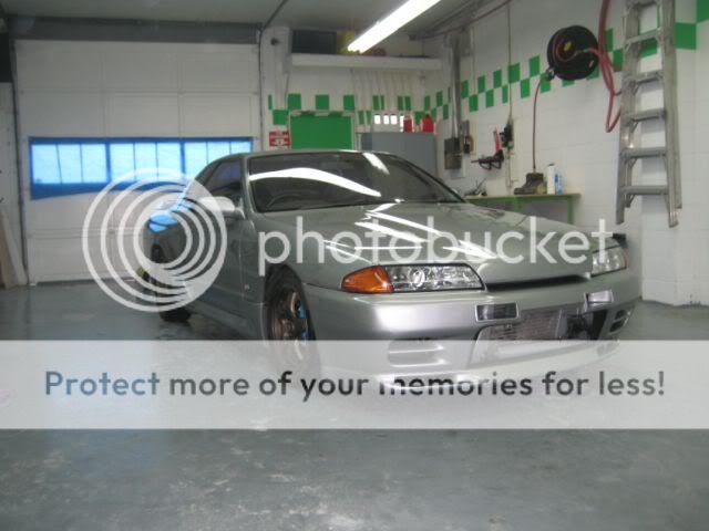

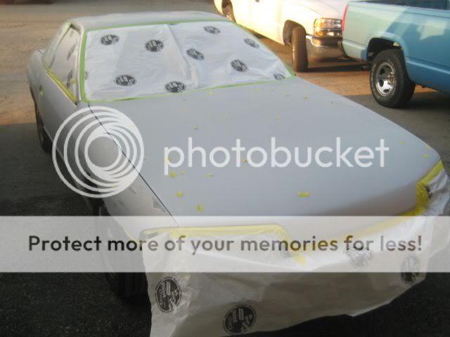

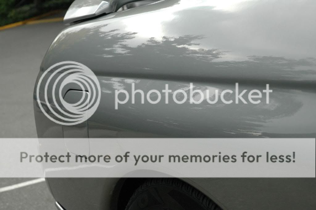

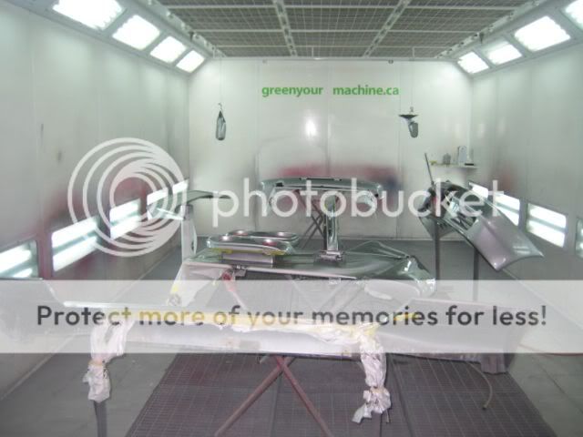

    This is the whole paint job i got from a respected private guy.
    KL0 - Z-tune silver with a lot of pearl
    primer, 2 coats, 3 clear
    ***Before*** Sparkling silver
    ***During***
    ****After****

                          Nice paint job!
