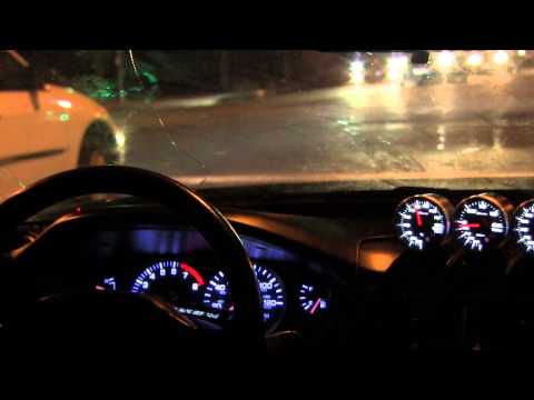

                  Changed out the bulbs in the cluster for some super whites.
                  Changed out the boost gauge for a Defi link unit.
                  crappy cell phone pic.
