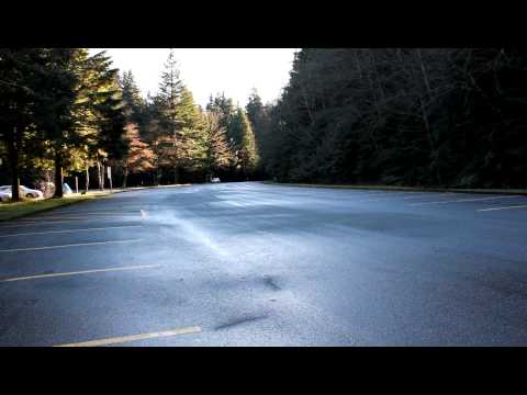

    test drive runnin on like 4 cylinders

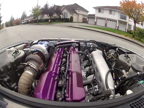

      so here it is, i let the car idle for 2 hours or so and its amazing how much better controlled the temps are with the new intake manifold and dual core rad. before the old crossover pipe would get too hot to touch now its still ice cold!
      valve ticking noise is completely gone as well, i guess it just needed to run for a while to loosen everything up or something.

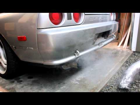

      heres a vid of the exhaust i swear this **** sounds sickk,

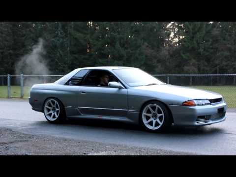

                    plasi dip`d the wheels white, got some good tires swapped on the new rims, rolled my fenders, took some photos, got bored, did some skiddin
