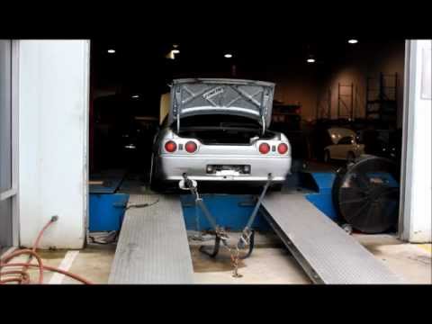

went down to racing greed this morning and turns out it was the tune causing the idle issue so after figuring that out and getting the car running right i say hey why not throw it on the dyno and turn the boost up a wee bit. so 23 psi later this is what i got.
im pretty excited about it, the car feels amazing and just keeps pulling.
Also right around the 20psi mark it started miss firing in boost, and i thought i had completely wasted my time using the LS2 truck coil packs but then i quickly remembered about adjusting the dwell and brought it up to the guy tuning my car, a couple adjustments later and booom no missfire!!
