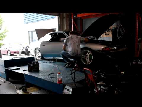

              heres a couple videos from the dyno sesh in june, just never got a chance to post them up!
              enjoy

                anyway the car made 250whp at racing greed at 18 psi kinda low but the car still goes like stink!
                ive already got used to it too i think im gonna get the boost turned up to 22ish pounds and get a re tune but who knows how long the stock internals will last at those power levels.
