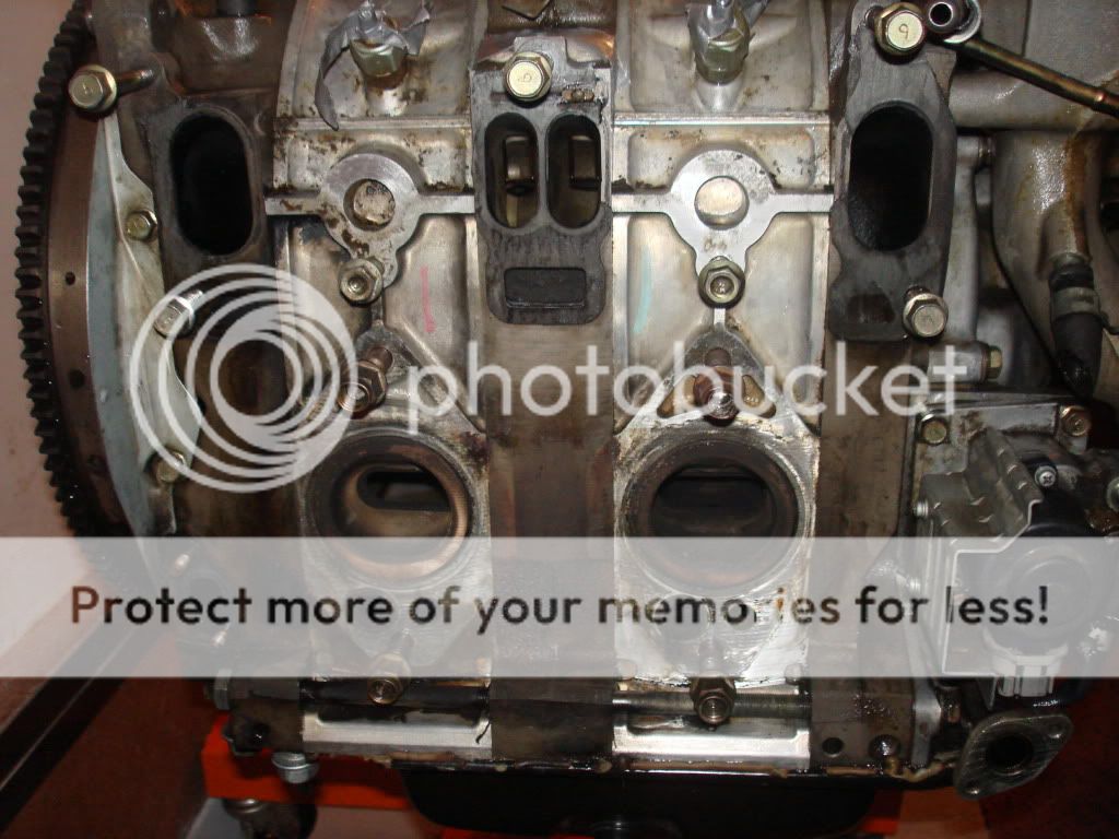

              Pic of my engine close up. Notice the red and green markings? This, along with the RTV that was used to seal the oilpan leads me to belive this engine has been rebuilt at some point in time.. good news!
