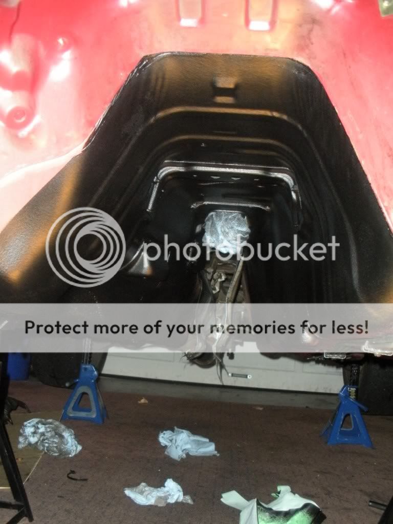

        So here's a quick shot of the trans tunnel. my camera died so I only got one pic. It was really clean under the heat shielding so cleaning it wasn't that hard. I POR15'd the few spots of bare metal and then coated it with gravel guard. VERY happy with how it turned out. It will keep my car rust/corrosion free for many more years.
        I'm doing it in stages... so I only have the transmission tunnel done thus far. I need to clean a few more spots before coating the res.
        I'm going to re-do the line where it turns to red. Didn't quite like how that turned out...

          Looking good Aaron

                            Where do you get this gravel guard? I think it will be a good winter project for my HCR also.
                                Crappy tire. Just make sure you get "rubberized undercoat" not the "asphalt undercoat"...
                                you need to clean it with some simple green and a bristle brush. Then rinse... let it dry, mask off and spray. the can is really good... very easy to spray where you want it to. nice narrow spray pattern.
