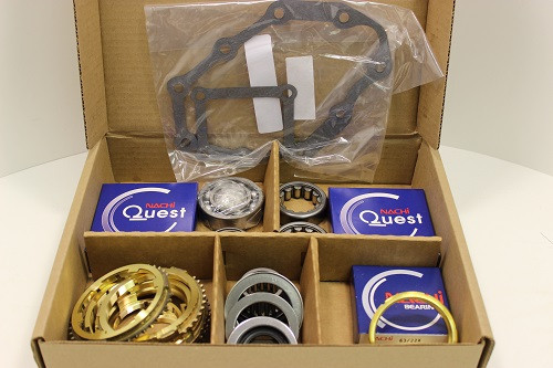

            Rebuild kit, $240 > http://www.ebay.com/itm/FS5R30A-Manu...3D221899051915

              Rebuild kit, $265 >
              Find many great new & used options and get the best deals for FS5R30A Manual Trans Bearing/Synchro Kit (Fits:Nissan300ZX/Pathfinder) BK240CWS at the best online prices at eBay! Free shipping for many products!
