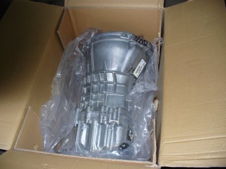

      Just for info I pay $ 2657.81 to buy new
      Part number is 32010-05U81
      R32

                would this kit be enought?
