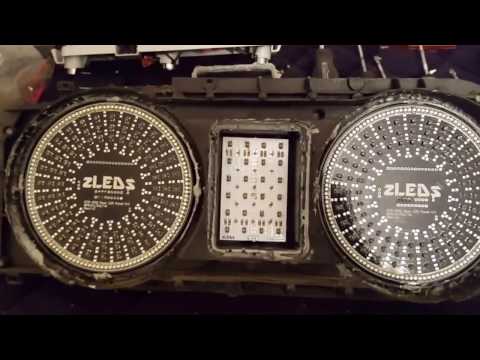

          Installed my ZLED taillight kit. Looks awesome and really makes the car stand out from the rest of the Skylines. I also made a DIY video if anyone is interested.
