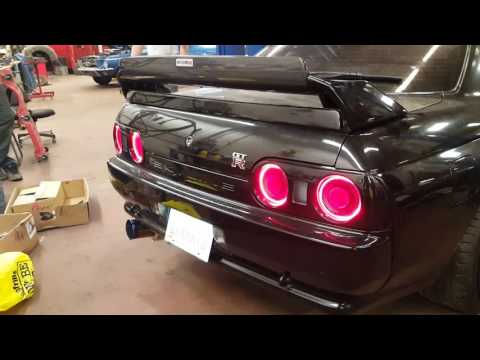

          I ended up taking the car to Speedtech to get inspected and go in for a base tune with my Sard high impedance 550CC injectors, R35 MAFs, and Power FC. Jesse from Speedtech suspected that the turbos were causing the smoking, and after leaving the car with them he confirmed that the turbos were shot. Video below.
          The "rebuilt" N1 turbos I bought off the forum years ago were garbage, and rendered not repairable. I ended up ordering brand new Garrett 2860R-5RS turbos. I wanted to get -9s for the faster spool qualities but found out they are discontinued. The actuators were upgraded with HKS units (not pictured). The engine was compression tested and was solid across the board (~150 psi).
