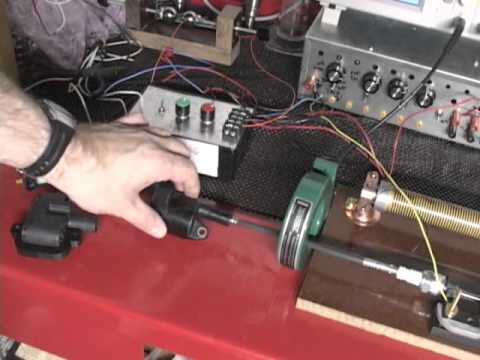

Here is the cool video where guy testing some GM coils. I read somewhere that this guy actually doing this testing originally for one of the simplest stand alone's ever - Megasquirt:

The only thing im going to do is to contact this guy from youtube and offer him to do some testing on the other coils. I have in mind older single coils from something like Nissan Maxima, Dodge waste spark coilpack's and may be some others. It would be very interesting to see how "TRUCK" coil would defend itself to some others coils in terms of output.
