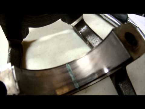

engine is alive and healthy as of now, I ended up using the same tensioner because im to impatient to wait a week and it looked new anyway. bolted it all back together and primed oil system before starting this time. just disconnected oil feed to turbo and with spark plugs out cranked until oil was coming out took about 2 minutes total cranking time.
main lesson to be learned - with any oil system part change like oil cooler, pump, or oil filter relocation.. prime oil system first to make sure its flowing and fix if not.
