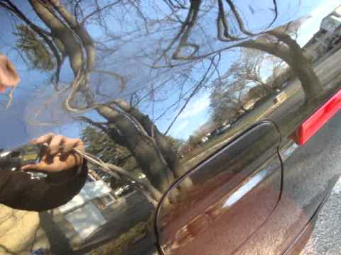

        New Detailer Pro’s wax! Give a nice wet-look with good reflection.
        • After-shot:
          See by yourself the nice reflection of the paint enhanced by this quality wax.
          Avec le peu de soleil qui avait, on a sorti l’auto pour mieux l’admirer. Je suis très content du résultat. Look hot! On sait que le noir est la pire couleur à travailler.
          Lucky for us and you, guys who's reading this thread, the sun game out at the moment we was done. Under the sun, you can see the true result of the polish, no have, no hologram, just a clear and nice result with very good reflection and under some angle like curved body panel, the paint can seems very wet-looking. thanks to my polish and DP's wax.

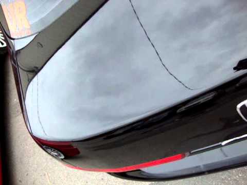

                      After shot:
                      Ironiquement, il m’a avoué que ce qu’il préférait sur ce detail était le détail des roues haha! Oh well.. enjoy !
                      Shiny like new!
