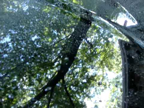

Have a look at this video, what I wanted to show is how the water sheet of the panel, same thing happens with contaminant, a good pressure washer regularly and you barely have to touch your paint to clean your car. It takes now fewer times to wash the car.
