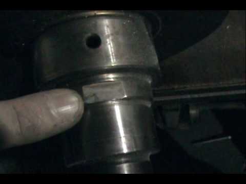

          I was replying to when he asked about how to check his turbos. The oil pump will fail easier in a 89-92 if you're on the rev limiter a lot (Not saying 93+ won't fail, they just improved the design). Best thing for a 89-92 GTR if you want to save the oil pump some pain, get an A/M collar pressed onto the crank shaft

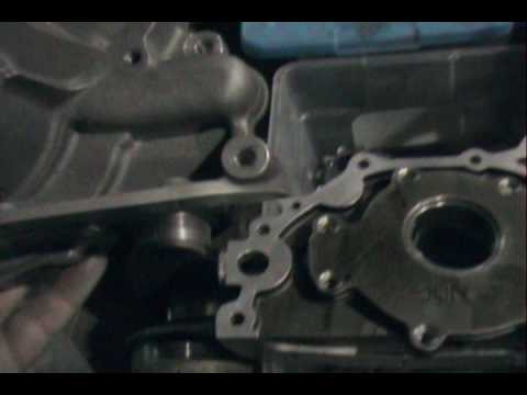

                Tomei pump is supposed to be the best. I've seen people on SAU say that JUN pumps have cracked in the past. Also, watch this for comparo between Tomei and JUN.
                edit: comparo between early and late crankshafts
