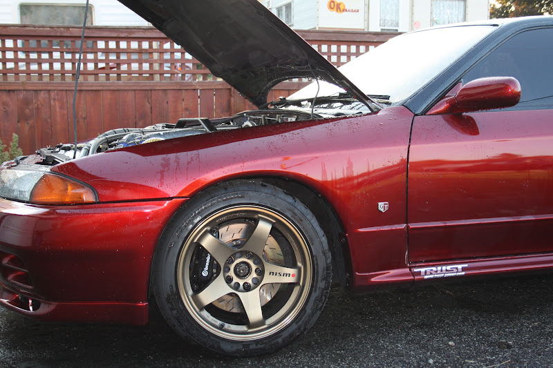

    I had an older build thread going but i left my Internet provider and i lost most of the pictures. So i am on to stage two, motor build. to look at the older thead, with no pics. http://forums.gtrcanada.com/showthread.php?t=20366
    Tuning:
    Apexi PFC
    Motec PLM
    FC Datalogit V2

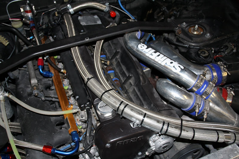

    Spec List:
    BNR32-001551
    ATL 22 gallon Fuel Cell with two surge tanks
    Bosch 044 pumps * 2
    Canton 1 micron filters
    Earls Check Valves
    -8an * 2 Feed lines
    -8an Return
    Sard 800cc green top injectors
    Sard fuel rail
    Sard Type RJ Regulator
    Battery mounted in trunk - Custom box
    Re and Re rear sub frame powder coat black
    NEW wheel bearings rear
    Re and Re CV boot kits rear
    Nismo Long Studs F&R
    Energy Poly Bushings
    Removed Hicas,A/C, Park Brake
    Defi BF Guages, Tac,Pyro,Boost,Oil Press,Water,Oil Temp
    Apexi PFC,Controler, Boost Kit
    Z32 AFM's new
    Trust 600*300*115 IC
    Trust T618z
    Trust Front Pipe 2 pc
    Custom recirc BOV kit
    Trust Raidiator
    Trust Coolent expansion tank
    Trust Oil Catch
    Trust Hard Pipe kit
    Trust Oil Cooler Relocate thermo
    OS Giken Superloc Rear
    Cusco Tension Rods Front
    Cusco Front Upper Camber -5mm
    Cusco Front Sway Bar
    Cusco Rear Sway Bar
    Cusco Rear Upper link
    Cusco Rear Toe Bar
    Cusco Rear Strut Bar
    Nismo Front Strut Bar and Master cyl stopper
    JIC Magic FLT-A2 Coilover 10 kg F 8kg R
    Custom Ti Exaust 90mm
    Custom Test Pipe with WideBand
    Motec PLM
    F50 Big Brake Kit Front
    Nismo LM 17" Wheels
    Nismo Engine mounts
    Nismo Transmission mounts
    Tomei 280 deg 10.25mm ProCams
    Tomei Oil Pan
    Tomei Oil Pump
    Tomei Bronze valve guides
    Tomei Lifters
    Tomei Spec C Spring kit +10,000 rpm
    Tomei Valve seats
    N1 Water Pump
    Cusco Cooling Plate
    Body and Paint:
    Full glass out restoration, Re & Re of any problem areas. Paint with two tone HOK Kandy BrandyWine with a Black roof and A&C Pillars

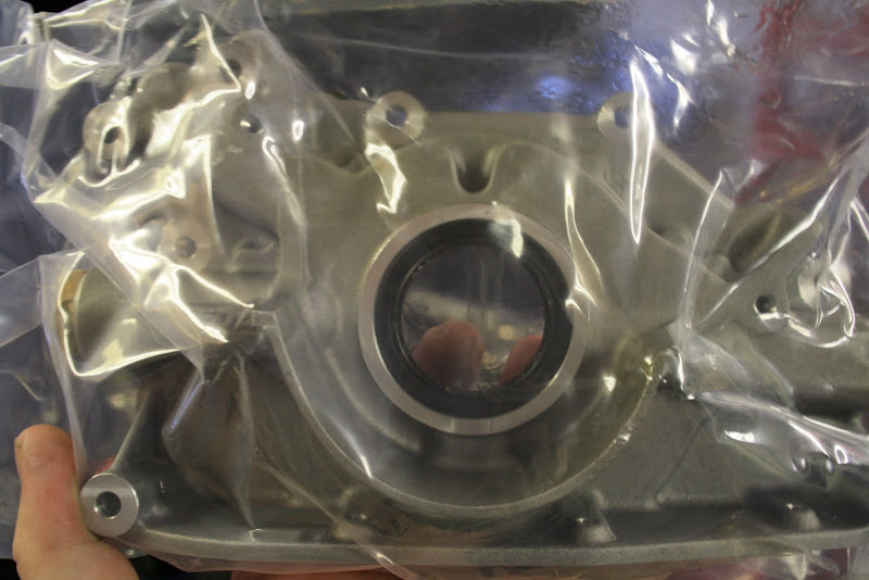

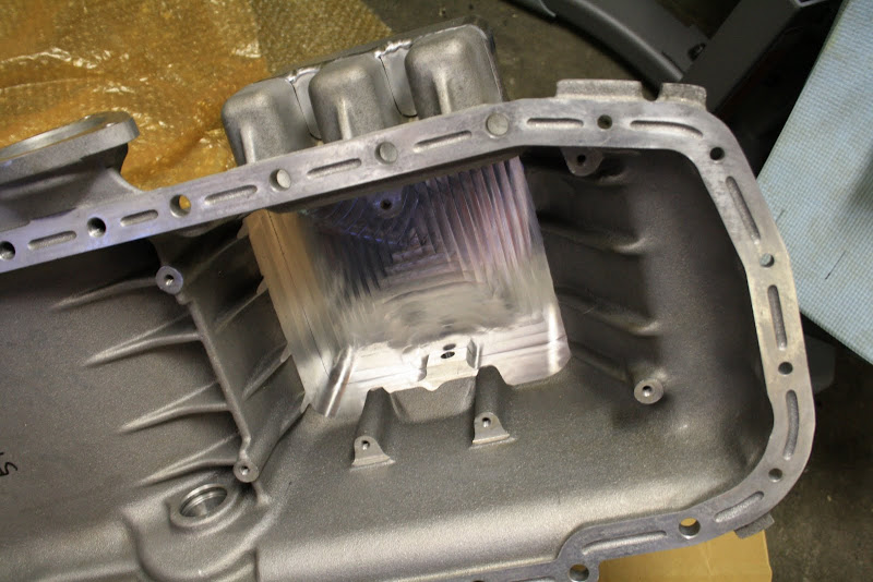

    Tomei Oil Pump

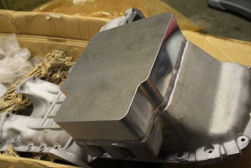

    Tomei Oil Pan Service (Pan Extention)

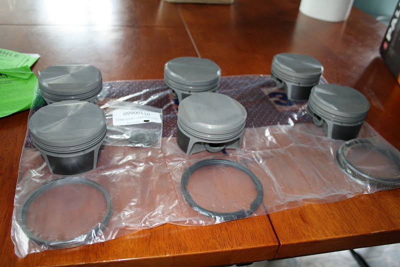

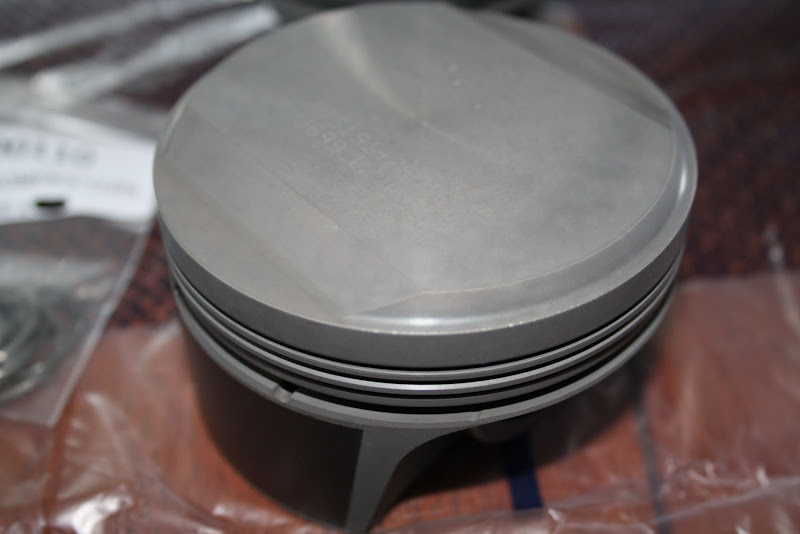

    Mahle Powerpak 87mm pistons

    Mahle PowerPak Pistons "slipper skirt"

                  Tomei Oil Pump
                  Tomei Oil Pan

                    mmmm sexpan.

                          The tomei pump and pan are a good choice. Not a bad way to speed $3000 lol. Could you PM me where you got them from? Thanks.
