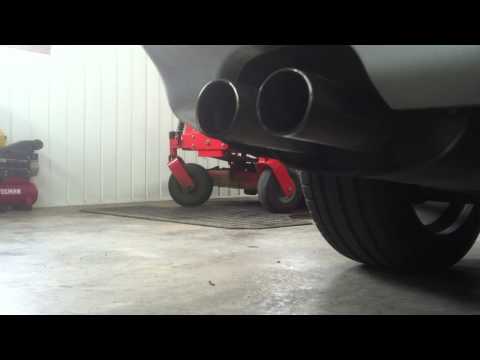

                        Here is a video I took on my phone of the stock exhaust.
                        Now with the Tomei exhaust installed.......way louder lol. It puts a smile on my face every time I start it up When driving the noise peaks around 3k then really drops off after that. The car also seems to boost a little quicker which is nice.
                        Another clip with the silencer in, noticeably quieter. The silencer fits in there very tight I had a hard time pulling it out.
