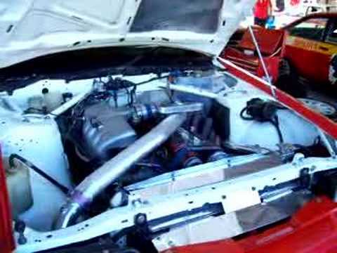

                            • If you cut intake penum apart and fitting divertor plates inside intake plenum to distribute air evenly to each runner, cylinders, that design works. But is not a good idea without the divertor plates. Makes tuning engine a nightmare with stock ECU. You can compensate via running engine richer via stock ECU (loss of hp) or via using individual cylinder fuel trim feature on aftermarket ECU's.
                              If they provided flow test result's to show it works, then I would believe it. Going by how a good intake plenum is designed, flow testing to prove it, that's the wrong way to do it.
                              The way they did it on Gibson GTS-R is the proper way -
                              If they found a better way, they would have done it.
