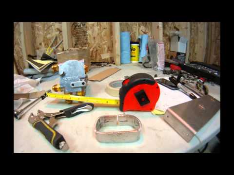

    • little movie i made just now from some pictures and video i took during my oil cooler install
