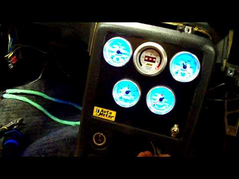

          installed AEM wideband that i got for xmas today, this is where i had the bung welded;
          wired the gauges so they light up when headlights are turned on with a dimmer
