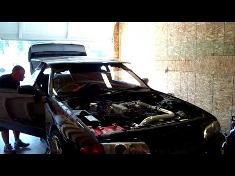

here's a video of the first start up. (runs no problem once you have the fuel lines the right way around)
