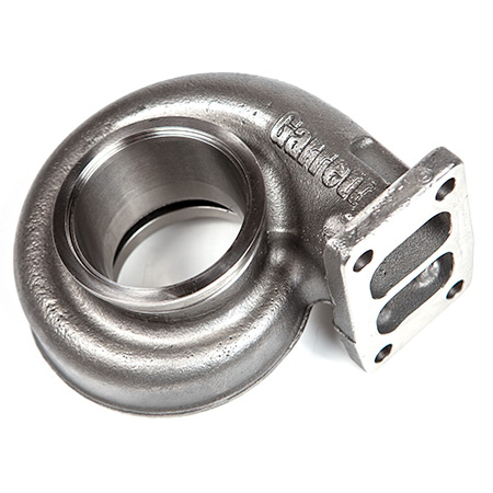

              • Thanks for all the support guys! I just got back from a 35 day stint in Fort McMurray (with only one day off). I probably won't have time to work on babyzilla until July-August. I just ordered my new .61 A/R Ni-Resist divided turbine housing.
