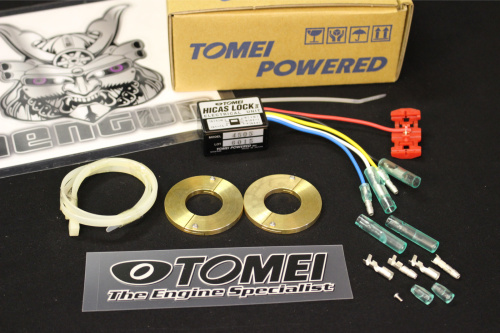

Can buy a Tomei HICAS lock kit that has this wiring part done for you (HICAS ECU) -
