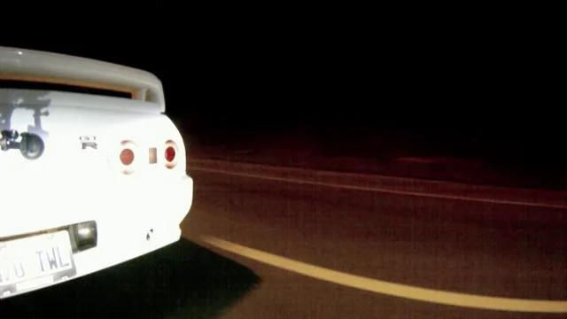

      • Originally posted by frankiman View Post
        mitch, activating his warp drive
        lol awesome vid
