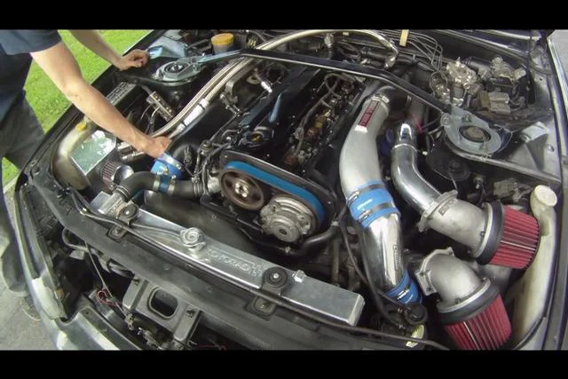

Its been a long time since I've updated this thread. A lot has changed, and a lot has happened.
Here's the specs:
Short Block:
Early R32 Rb26 Block
R34 Crank
Eagle Rods with ARP2000 Rod Bolts
CP Pistons 86.5mm
Rods where fixed by the machinist to be a circle within .0002"
Blueprinted Short Block, balanced with flywheel to 11000rpm
ACL Race Bearings (Rod and Mains) Stock Size, no plasti-gauge used, everything done with dial indicators and bore gauges
Block Oil Drains Enlarged
Tomei 1.2mm Oil Feed Restrictor on Head
Tomei 1.2mm Headgasket
N1 Water Pump
Nismo Oil Pump (not a N1)
Tomei Oil Baffle Plates
Nismo Engine/Tranny Mounts
Nismo Thermostat
Head:
Ported by TK Race Heads
Brian Crower Titanium Retainers
Supertech Valve Springs (good for 10,000rpm)
Tomei PonCams Type-B
3-angle Valve Job
Greddy Timing Belt
Ferrea Intake and Exhaust Valves (some special alloy Formula 1 spec valves, I had to special order them took like 6weeks to get them made and shipped)
Supertech Exhaust Valve Guides
ARP Head Studs
Fully Clearanced and done Head (the head is the best part of my motor I think)
Fuel System:
Injector Dynamics ID1000 Injectors
Denso Supra TT fuel Pump
Aeromotive A1000 FPR
Aeroquip Fittings and Lines -6AN
Tomei fitting on fuel Rail
Exhaust System:
Stock r32 ported exhaust manifolds
Tomei Expreme Dumps
Mines Downpipe
Custom Agtronic Test Pipe
Kakimoto N1 Full Mega Catback
Suspension:
NPG Bridgestone Coilovers 12k/8k
JDM RUCA
Nismo Traction Arms
Kazama Hicas Lock
Aluminum Diff and Subframe Bushings
Brakes:
Nismo Discs all round
Hawk HPS Pads (finished during a track day, now I need something better)
Goodridge Brakelines (from the UK)
Turbo:
GT2860r-5 Turbos
AN Oil feed lines
PHR Oil Catch Can with -12AN Lines
Clutch:
Exedy Hyper Twin Clutch with chromoly flywheel
Nismo Clutch Pivot Ball
Electronics:
Defi Din Gauge
AEM EMS ECU
AEM 3.5Bar MAP Sensor
AEM UEGO Wideband
AEM Boost Solenoid
ICE:
Alpine CDA-9887 iPod
Alpine Type-R Tweeters and Front Speakers
Infinity Rear Speakers
Wheels:
R34 GTR Wheels
Azenis RT-615 Tires
Intake/Cooling:
Apexi Filters
Synapse Synchronic Blow Off Valve
Greddy Intercooler Piping
Divided Y-pipe
Koyo Radiator (the big one)
Greddy Thermostated Oil Cooler 13-row
New bolts/washers everywhere, new timing belt bearings, r34 crank sprocket, etc...
There's other stuff, I can't remember.
Car makes 465whp @ 19psi on a Chassis dyno on 94-octaneLast edited by mitch32; 10-21-2010, 01:20 AM.

also haven't seen the engine bay with the coilpack cover on till now, looks much cleaner
